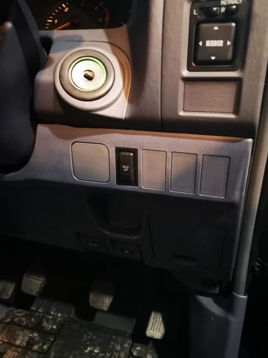

I started with the easiest. IDLE up. If you look behind the switch blank down below your steering wheel on the RHS, you should see several wiring harnesses. One of these is for the IDLE UP, which appears in some markets. This sends a signal to the ECU to bump the revs to 1200rpms, when not moving. Handy when warming up in the cold, OR running heavy electrical loads at idle, such as winches, AC, etc.

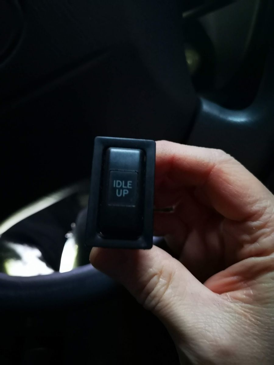

So, you don't have the option? Simple. Buy the switch. (Used at this point, since Toyota seems to be sold out worldwide). Find the harness under the dash. Plug the switch in. Done. When you start to roll, the engine will readjust to normal again, until you come to a complete stop again, when it will bump up to 1200 again. To it off, simply press it again. Easiest mod you ever made.

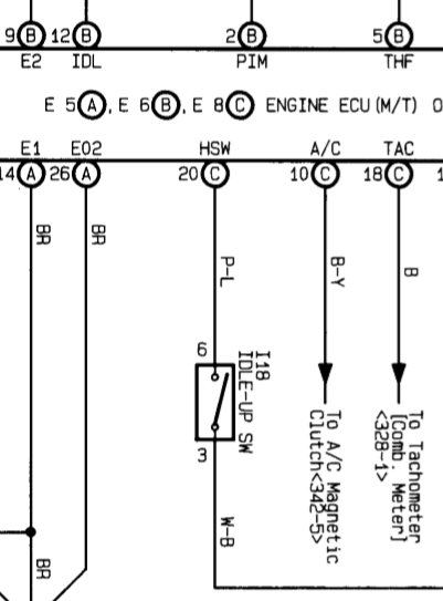

Looks like Pin c20 (connector E8) looking at the wiring diagram. If there is already a pin present in the connector, you want to find the wiring harness behind the lower switch blanks on the drivers side of the car. I had to buy a pin and run my own wire to the ECU. It wants a momentary switch but a non momentary switch will work but to turn on or off requires 2 presses.
This ECU pinout is 90 series 1kz but this may change before/after June 2000 and is different for 120 series. Not all 1kz came with the wiring harness over to the drivers side of the dash.
Further info here (120 series pinouts in pictures)
